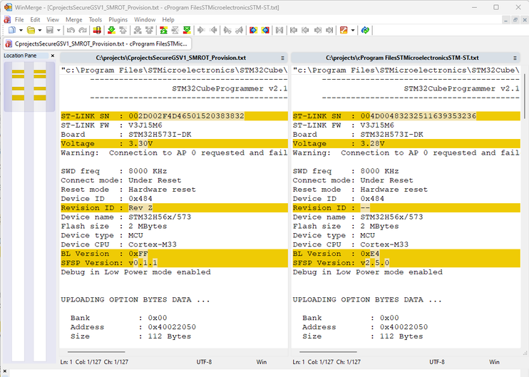

‎2024-11-13 9:06 AM
Thank you @Jocelyn RICARD I compared the outputs, it appears all the option bytes are the same, only the boards have some differences (left is mine, and right is yours).
‎2024-11-13 9:51 AM
Hello @Thatseasy ,
OK so the issue is the board. SFSP 0.1.1 which is the version of the system flash secure part is very old and will not work.
To get Secure Manager work you have to get a new DK board.
Best regards
Jocelyn
