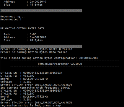

The regression.sh script execution got failed:
Due to this issue, unable to flash the software image into the HW with both TFM_UPDATE shell script and STM32Programmer approach.

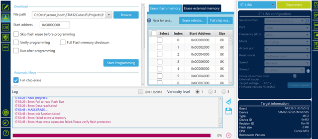

Further while trying to do the mass erase operation for the flash using STM32Programmer, getting below erros:

17:53:45 : MASS ERASE ...
17:53:45 : Error: Init function failed
17:53:45 : Error: failed to erase memory
17:53:45 : Error: Mass erase operation failed.Please verify flash protection

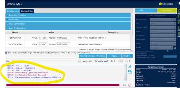

We tried the Option byte write process to resolve this issue as well, but getting issue defined in the log and snap below:
Error: Uploading Option Bytes bank: 0 failed
Error: Reloading Option Bytes Data failed
So could you please support to resolve this issue.
