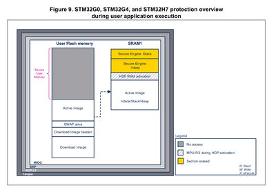

I am now looking at the example of the NUCLEO-H753ZI (2_Images_OSC) and the picture looks different.
This is from the manual UM2262:
So actually, not only the stack but also the SE volatile data cannot be touched. Which in the linker file (and MPU configuration) is actually whopping 12KB DTCM RAM that is being protected.
sfu_low_level_security.h
#define SFU_PROTECT_MPU_SRAM_SE_SIZE MPU_REGION_SIZE_16KB
#define SFU_PROTECT_MPU_SRAM_SE_SREG 0xC0U /*!< 16 Kbytes / 8 * 6 ==> 12 Kbytes */

So as you can see, the application RAM starts after 12KB of SE_region_RAM, and funnily enough, does not include the HDP region?
I am completely lost here on what is going on actually. So much information out there but it's all confusing and insonsistent. User application neither starts at 0x20001100 (as you say), 0x20003100 (as would have made sense here) but 0x20003000 (which does not include the HDP region).

Regarding the usage of the RAM used by SBSFU and SE, except if you used the image validation feature, I don't see any reason why you couldn't use it. Only possible protection is the MPU and if MPU is still active when jumping into application (sorry I don't remember of this point), this it is easy to reconfigure it.
The main protection on the STM32H753 is the Secure memory that protects the flash area containing the secure boot. The RAM has not specific protection except MPU.

Now regarding DTCM usage. As I said you can reuse all of it. There is no specific RAM protection on STM32H753
If you enable firmware validation, the firmware image state is stored at end of DTCM:
__ICFEDIT_SB_region_RAM_end__ = 0x2001FFEF;
/* Shared RAM for Image State Handling */
__ICFEDIT_SB_FWIMG_STATE_region_RAM_start__ = __ICFEDIT_SB_region_RAM_end__ + 1;
__ICFEDIT_SB_FWIMG_STATE_region_RAM_end__ = 0x2001FFFF;
So, in such case, you should keep it in your linker file so that secureboot can get the information.
