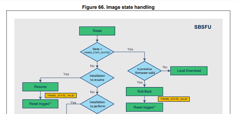

Fred
Yes, you can check Appendix J figure 66 in UM2262:
0693W00000NrGT7QAN.pngIf the previous firmware image is not tagged valid then we end up in local loader mode.
Nevertheless, if the firmware got corrupted without the valid state being updated then maybe you can revert to an invalid firmware. You must check this kind of cases.
Using UART increases the attack surface, so yes you open the door to new risks.
You must assess carefully the code dealing with the UART communication and decide if you trust it or not.
As soon as you transfer data, you deal with buffers so you can have bugs in this area leading to security breaches.
