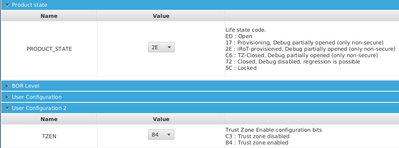

While adapting the example code (OEMiROT) to my own version, I am currently in the situation where the device is "provisioned" (0x2e), but I have lost the keys/certificates because they were accidentally overwritten during my experiments. So I can't open up the debug access port anymore. TrustZone is enabled (0xb4).

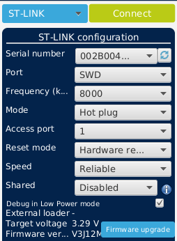

Currently with the STM32CubeProgrammer I can connect to the device in hotplug mode:
And I can read out the registers:
After doing some research for other ST platforms (the STM32U5 for example), it seems to be possible to "unprovision" the device using the STM32CubeProgrammer. However, changing both the PRODUCT_STATE and TZEN registers to 0xED and 0xC3 respectively results in an error:

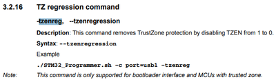

Additionally, the STM32CubeProgrammer manual documents a possibility to disable TrustZone via CLI (https://www.st.com/resource/en/user_manual/um2237-stm32cubeprogrammer-software-description-stmicroelectronics.pdf:(

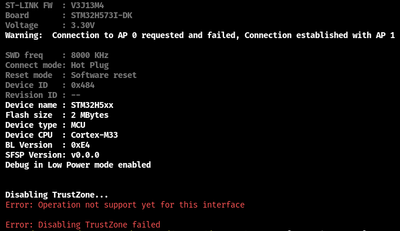

Alas, this method does not work as well as the command does not seem to be supported for the interface:
STM32_Programmer_CLI -c port=SWD mode=HotPlug -tzenreg
Is there any possibility to revert the product state and/or disable TrustZone on the STM32H5?

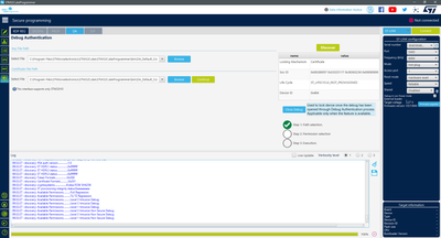

If you have the ST provisioning integrity status value equal to 0xeaeaeaea this means that debug authentication is provisioned.
Now, if you have overwritten the keys, it may have been done using the TrustedPackageCreator by regenerating the key using "Regenerate" button. In that case, the old key is saved in a .bak file containing also the date and time in the file name.
The only thing you need it the root private key you used when provisioning the device.
Also, if this is the default one provided in the package there is no issue.
If you generated your own private key, provisioned the device with associated public key and completely lost this private key, you will not be able to recover in any way. This is the purpose of the debug authentication to be able to authenticate ...
