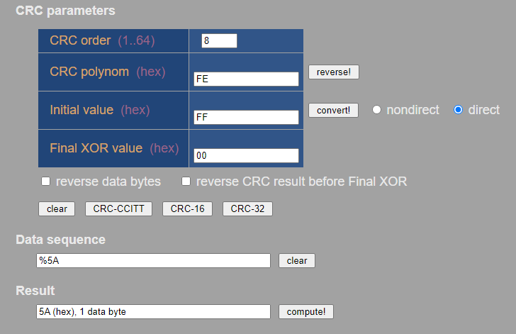

I currently use STM32L073 for evaluation and found some issue with CRC module.
L073 has a CRC peripheral whose polynomial is programmable. And when I programm the peripheral as below, the checksum returns from the module doesn't match the one from a 3-party calculator -- it has an extra XOR with 0xFF.
The peripheral configuration is as below. In this case, both the 3-party calculator and my software code get a result of 0x5A but the CRC peripheral in the L073 gives a result of 0xA5 (which is 0x5A XOR 0xFF). Same happens for other data input.
CRC->CR = 0x01;     //  reset CRC module
CRC->CR = 0x10;     //  8-bit polynomial
CRC->POL = 0xFE;    //  set polynomial
CRC->INIT = 0xFF;   //  set initial value
*(__IO unsigned char *)(CRC_BASE) = 0x5A;   //  8-bit write to CRC->DR register
result = CRC->DR;   //  readout CRC checksum

What's that 3rd party calculator? If it performs the final xor, well then you have to perform it too.
Hi JW,
Thanks for your reply.
It's here: http://www.zorc.breitbandkatze.de/crc.html
It does have a "final XOR" configuration but unfortunately I put a "0" there. See below:
0693W00000BcmXXQAZ.pngI did some further investigation and seems if the LSB of the polynomial is "0" (in this case 0xFE = 8b11111110), the L073's CRC adds a final XOR with 0xFF to the result.

From the CRC chapter in RM:
Polynomial programmability
The polynomial coefficients are fully programmable through the CRC_POL register, and the
polynomial size can be configured to be 7, 8, 16 or 32 bits by programming the
POLYSIZE[1:0] bits in the CRC_CR register. Even polynomials are not supported.
Ah I see. Thanks a lot. I missed that "Even..." part.
