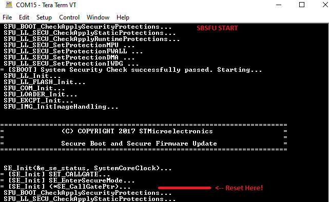

When the Secure Engine Call (inside SE_Init() function) is called in this line:
e_ret_status = (*SE_CallGatePtr)(SE_INIT_ID, peSE_Status, primask_bit, uSystemCoreClock);
(which is between a SE_EnterSecureMode and SE_ExitSecureMode).
The MCU resets at this point, the reset happens continuously (reset loop) always at this line. The code executed until after SE_EnterSecureMode(&primask_bit); is called. I have added TRACE calls to check this.
Here is the problem area:
/* Enter Secure Mode */
TRACE("\r\n= [SE_Init] SE_EnterSecureMode...");
/* Secure Engine Call */
TRACE("\r\n= [SE_Init] (*SE_CallGatePtr)..."); //RESET HAPPENS BELOW:
TRACE("\r\n= [SE_Init] (*SE_CallGatePtr) done");
/* Exit Secure Mode */
TRACE("\r\n= [SE_Init] SE_ExitSecureMode...");
SE_ExitSecureMode(primask_bit);

I have no idea what is happening. I'm not even sure it's the firewall spurious reset. I disabled SFU_FWALL_PROTECT_ENABLE define and the same issue persists. Also if it was an actual firewall (or other reset) I would get the TRACE printout telling me that. This is just a inexplicable reset.
Any help is appreciated. It's a complete showstopper with SBSFU.

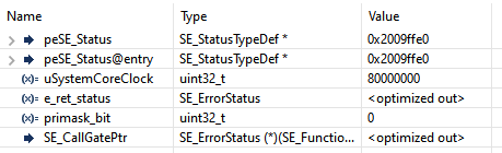

So the value of SE_CallGatePtr is <optimized out> when I stop program before that line is executed (by breakpoint).
As for protections, I can see from Option Bytes read through STM32CubeProgrammer that Read Out Protection is AA: Level 0. Also PCROP and Write Protection in Bank 1 are also disabled. These have to be disabled anyway to reprogram/flash device and debug. For firewall specifically I don't see anything in Option Bytes > User Configuration or anywhere else.
For the SE_CallGatePtr being optimized out - could that be an issue? however why does the example project work for the STM32L476G-DISCO board without any issues? As I said I only modified few things and am testing on the STM32L4R9I-DISCO.
Would it help if I sent you a .zip of the SBSFU+SECoreBin projects?
‎2021-05-28 10:33 AM
The SE_CallGatePtr is set with this function:
#define SET_CALLGATE() \
SE_ErrorStatus(*SE_CallGatePtr)(SE_FunctionIDTypeDef ID, SE_StatusTypeDef *peSE_Status, \
...); /*!< Secure Engine CALLGATE pointer function*/ \
SE_CallGatePtr = (SE_ErrorStatus(*)(SE_FunctionIDTypeDef, SE_StatusTypeDef *, \
...))((uint32_t) SE_CALLGATE_REGION_ROM_START + 1U);
It is fixed to SE_CALLGATE_REGION_ROM_START + 1U. What is the value of SE_CALLGATE_REGION_ROM_START from your linker configuration? Better yet, go into the project .map file and search for it to find the actual value the linker placed it at.
The arguments could also be a problem and source of faulting. peSE_Status is a pointer to 0x2009ffe0. This a region located at the very end of the 384 KB SRAM3 area (0x5FFE0 into 0x60000 total available) of the L4R9 device. It must be pointing to a stack location 32 bytes down from the top. This has to be where SBSFU is operating out of right now.
‎2021-05-28 12:33 PM
