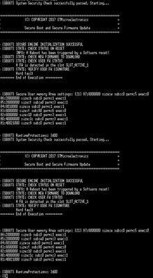

I  changed symbol in the properties tab to adapt STM32G0B1xx drivers causing hard fault after loading User App. The hard fault occurs in sbsfu while verifying the user fw signature.
can someone help me why fw signature verification failed just changing  symbol to STM32G0B1xx ?
