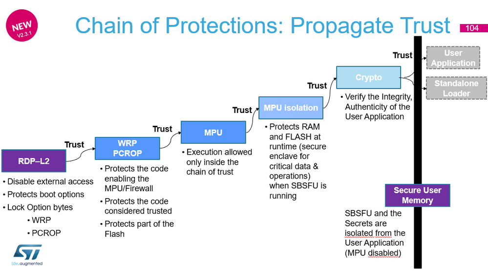

For SBSFU, i want to apply SECURE Mode + Secure Memory (sector 0) + PCROP (Key data) + WRP (sector 0) + RD LEVEL 2 + MPU (SBSFU - RAM), is this looks promising ??
With SBSFU we really follow the concept of layered security.
Therefore, the first thing I usually tell people to do is to make a diagram of their chain of protections.
With the vanilla X-CUBE-SBSFU we provide as example for H7, the chain of protections is like this:
So, this is what you can do to have a clear view of your security layers.
This is the SBSFU part, you need to do the same for your application.
Of course, this is not a security analysis, it is more a first step towards the security analysis.
Once you have this view, then it is time to check how this system protects your assets, then identify the threats, vulnerabilities and countermeasures.
