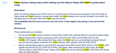

Hello @Brigei
check STM32L031xx/L041xx device errata - Errata sheet section 2.1.2 :
waclawek.jan
Hi @Sarra.S ,
IMO the quoted erratum does not apply to this case:
The erratum talks about invalid FLASH fetch. This is obviously not the case here: the first FLASH fetch after wakeup is the interrupt vector fetch, and that is obviously correct, as execution reaches the ISR. The problem is the incorrectly stacked registers. In other words, the problem is *not* FLASH fetch, the problem is *register stacking in SRAM fails*, i.e. it's the SRAM which is problematic after wakeup.
Hey @waclawek.jan
This is related to the flash wakeup time when the system is waking up from LPSLEEP.
The first instruction fetch from Flash after waking up is incorrect due to the Flash not being ready (as described in the errata, recovery time is needed), the POP that attempts to restore the PC from the stack could end up fetching the wrong address for the PC, and the CPU will resume execution at an incorrect address leading to hardFault.
As the workaround suggest and I think @Brigei tested it, removing the line that puts the flash in power down mode will solve the issue.

If you look at screenshot in 3.jpg in @Brigei 's post above, PC points to the correct address of first instruction in LPTIM1_IRQHandler(). However, what is not correct there are the stacked registers.
Also, the whole thread is about the fact, that the hardfault does *not* occur immediately after the wakeup, but that *whole* LPTIM1_IRQHandler() after wakeup is executed correctly (that's many many fetches from FLASH, all correct), and that the hardfault occurs upon *exit* from LPTIM1_IRQHandler(), when the incorrectly stacked PC is popped from the stack.
So, as I've said above, the problem is *not* incorrectly woken up FLASH, but that 7 out of the 8 register values stored to RAM during the stacking upon ISR entry are not written by the processor into RAM at all, and those RAM places retained their previous values. Again, refer to the screenshots in @Brigei 's post above and their descriptions, they very clearly indicate the problem, and it very obviously is NOT consequence of incorrect FLASH fetch.
That the problem appears to go away by disabling FLASH powerdown, is IMO coincidental, thus without further investigation of the true mechanism of problem should not be considered to be a solution to this problem.
