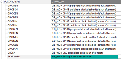

I am trying to use the backup SRAM but get a hard fault when writing to the memory. I have unlocked the backup domain, enabled the backup regulator, and enabled the clock. What other step am I missing?

I did also verify the BKPRAMEN bit is being set. And the MPU and cache are both disabled.

‎2024-09-27 3:03 PM
> that only enables and disables access to the control registers
Nope
‎2024-09-27 3:11 PM
Thanks I’ll try that on Monday.
‎2024-09-28 8:49 AM
Yep that did it. Thank you for reviewing the code and quickly finding my mistake!
