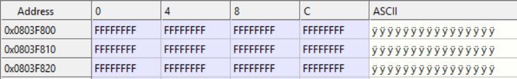

im new for Stm32. I want to write 4 numbers in the flash but always get an error message (status = HAL_ERROR while writing in flash). In my function I write the numbers in an array and want to write the individual elements into the flash.
The variables (zahlx) are uint8_t.
Can anyone tell me what I am doing wrong?

Thank you for your answer. I'm using a STM32L433RC.
The page I want to write on is empty.
I want to write on the last page, so i define 'FLASH_STORAGE = 0x0803F800'.
To detect the problem, i read the flash error code.

It fails immediately, the result is: "Error code: 224 for data 0"
what does this code mean?

Flash memory on STM32L4 can be programmed only by special 2*32-bit block write procedure and it must be 8-byte aligned.
Read the reference manual section 3.3.7!
In HAL_FLASH_Program(), instead of a million useless code lines of bloat, they could've done address alignment checking, but of course that's not the case...
