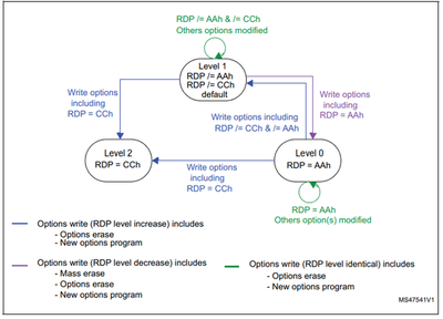

2024-09-06 9:13 AM
The RDP option byte is set to 0xCC:
Best Regards.
STTwo-32

2024-09-06 8:55 AM
How does a device get a Protection Level 2?
2024-09-06 9:13 AM
Best Regards.
STTwo-32
