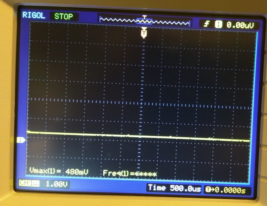

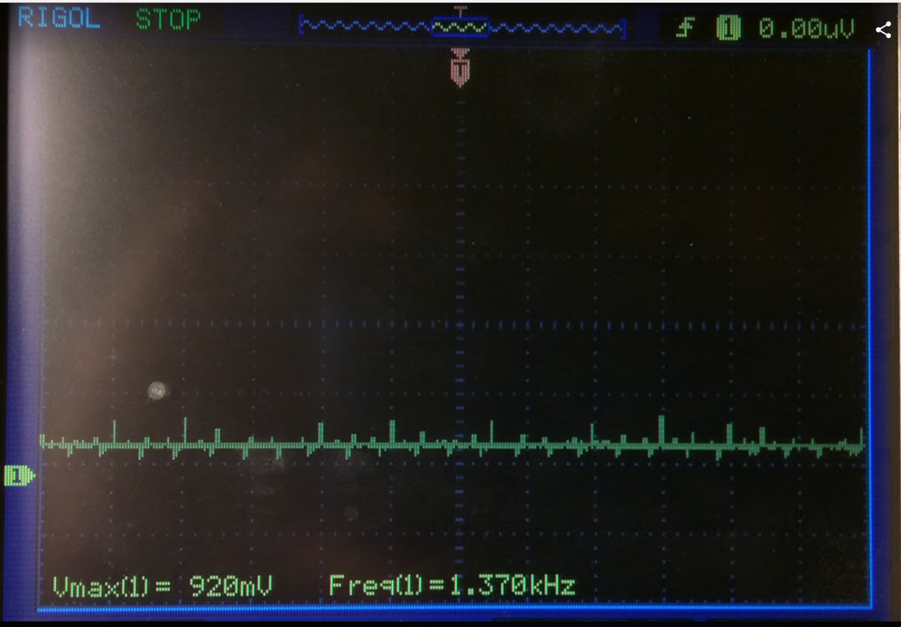

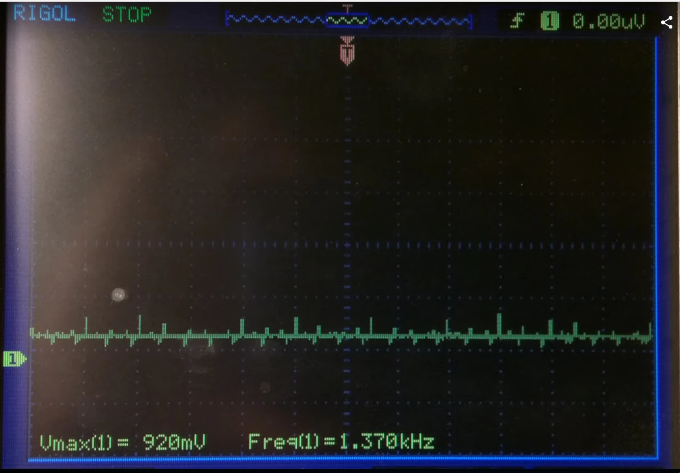

    I'm measuring the analog output-signal from a RF power detector, specifically the ADL5903. It does not have any input, but the output is nevertheless 480mV, so that's what I'm trying to read.
    At first I thought the higher values I read was the jitter on the measured signal, as seen below:
    But then I decoupled the signal with a capacitor and it looks like this now:
    So I don't believe it's a physical thing, the signal is clean and I've traced it over time. After the decoupling the read signal i far more stable though, in both ends (now it's almost exactly 390 or 1650 each time, before it deviated more).
