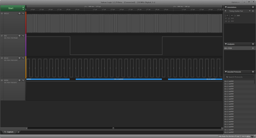

Hi guys,
Finally started injected known data into the I2S bus and I am seeing indifferences on the line and was wondering if you guys can explain this to me if this is normal or not.
Using the STM32H753ZI
Figure 1:
Sending: 0xFF FF (16 bits)
DATLEN = 16 bits
CHLEN = 16 bits
Figure 2:

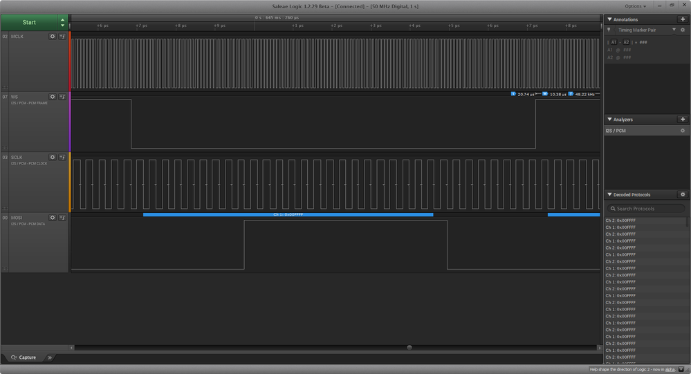

Sending: 0xFF FF FF (24 bits)
DATLEN = 24 bits
CHLEN = 32 bits

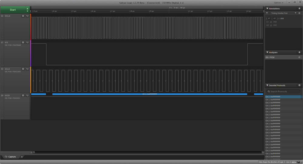

Sending: 0xFF FF FF FF (32 Bits)
DATLNE = 32 bits
Why when it comes to sending 24 bits I am missing a byte?
Another thing I noticed when sending 24 bits for example if sent 0x010203, the bus will receive 0x000102 its like performing a >> shift by a byte

Hard to say much without seeing code. Clearly the middle example is not sending 0xFFFFFF. Gotta be a bug somewhere.
You should be sampling on the rising edge, not the falling edge.

Okay, so there's initialization code posted not, but not the code used to actually send data.
> SPI3 -> I2SCFGR |= SPI_I2SCFGR_DATFMT_LAlign;
Maybe you're just not aligning your data correctly. Are you sending 0xFFFFFF or 0xFFFFFF00? Regardless, try the other one. Or instead leave data right-aligned (default).

With a lot of alone time with the logic analyzer and a lot of more reading of the reference manual, I finally figured it out.
I am Sending 0x00 FF FF FF (32 Bits). Whats happening since its Left Align and DATLEN = 24 bits, it will read the first 3 bytes as its suggested in the RM0433 Pg.2227 Figure 638. When I switched the Left Align to Right Align the I2S Bus then produced 0xFF FF FF 00 where the zero is ignored.
So its been working correctly, just didn't understand it.
