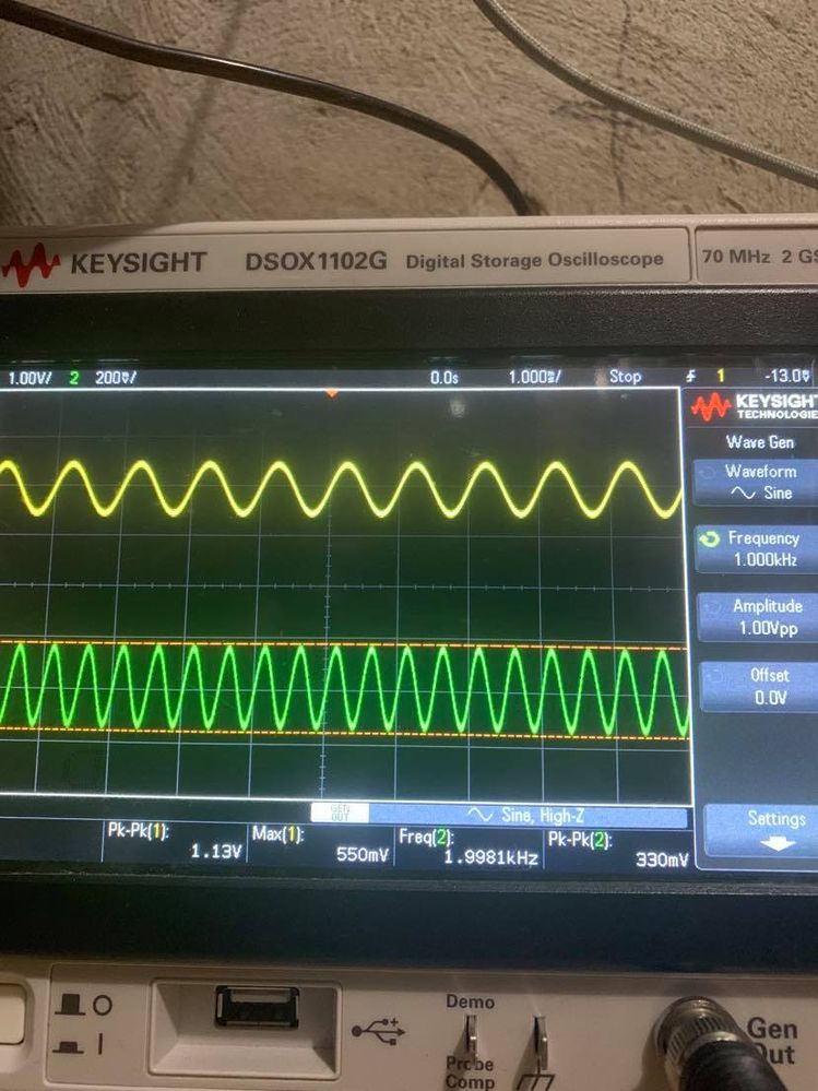

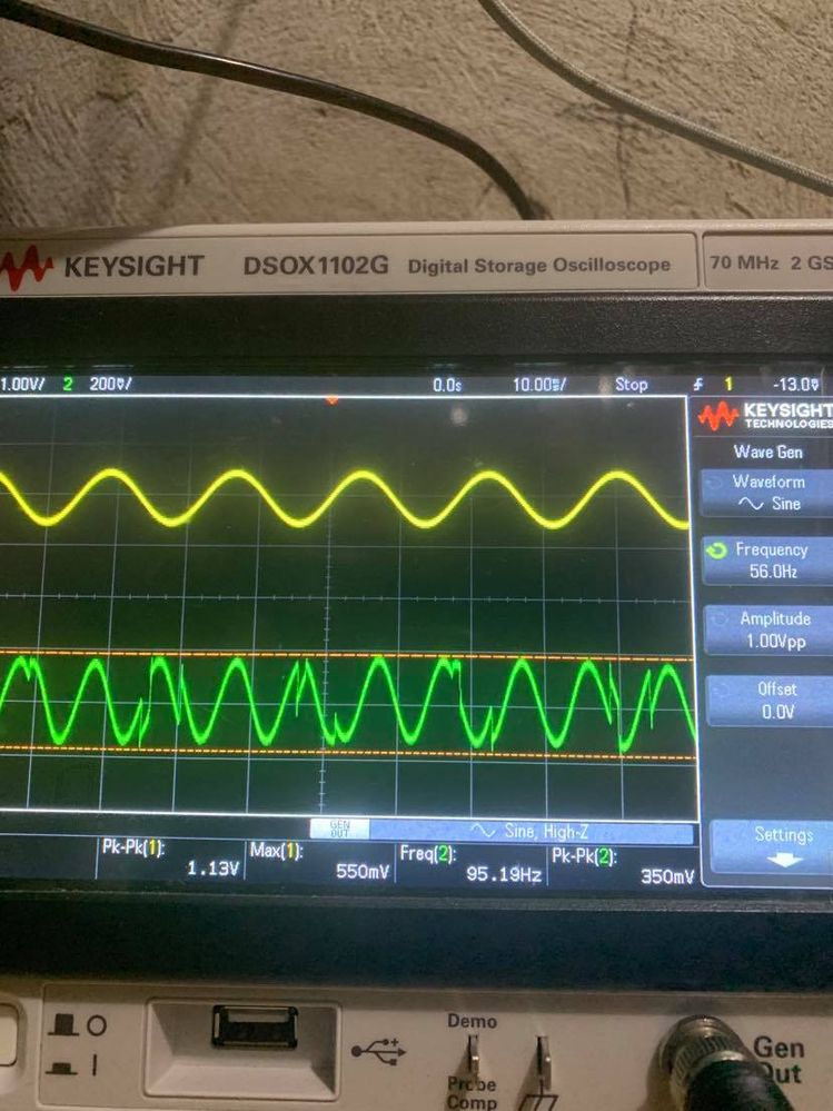

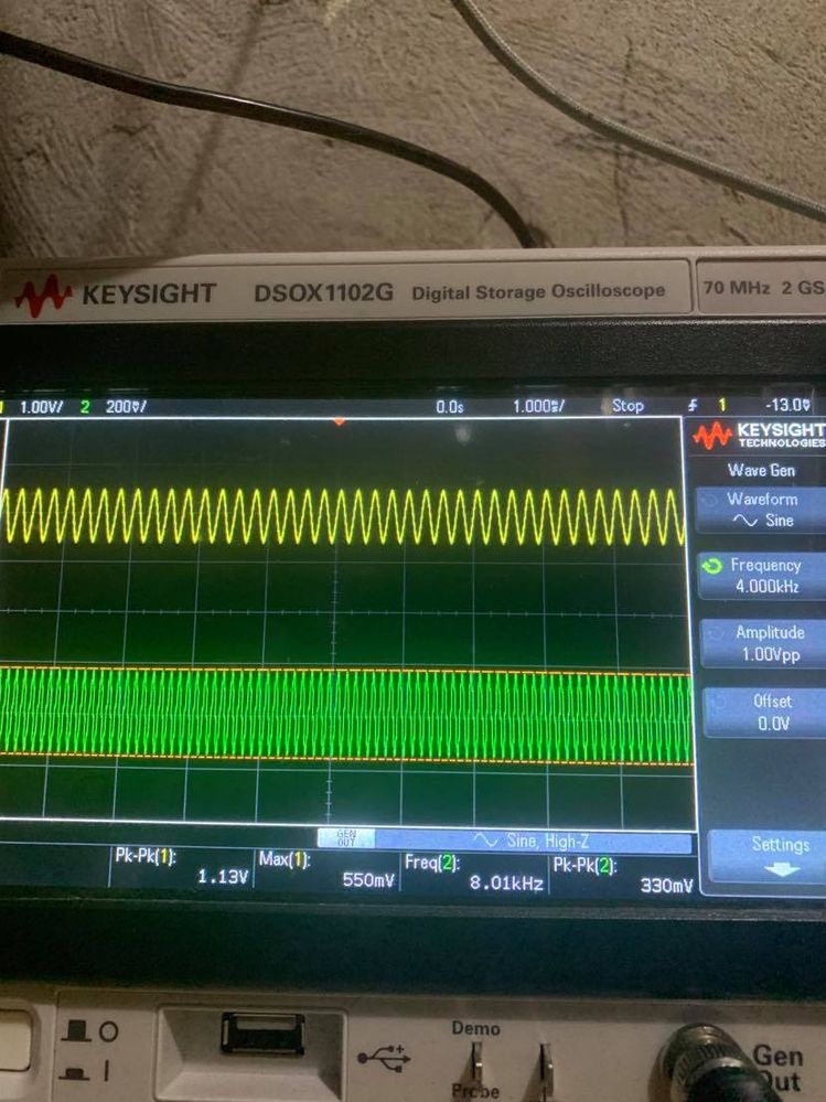

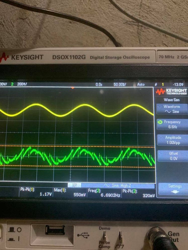

I'll try to explain everything with detail as this is one will be a hard one to explain.
Essentially what I am trying to achieve is sum both the left & right channel to produce a mono signal to be outputted via I2S as the subwoofer line.
The problem I am having right now is that after summing the samples and sending it back to the peripheral I am observing at least double the frequency compare to the input and I have no idea why. Also at lower frequencies the signal looks chopped (see pictures)
What I have done for you is:
  • Ensured the I2S Clock is running correctly
  • Without summing just sending 1:1 samples and it's a mirror image of the input
The I2S3 DMA is setup as follow:
  • Length = 2048 (Tx_BUFF)
The I2S1 DMA is setup as follow:
  • Length = 4096 (Rx_BUFF)
  • Length - 4096 (Tx_BUFF)
Code: I2S_HALFCOMPLETE_CALLBACK()

Results: @ 6Hz
0693W00000BaqUdQAJ.jpg@ 56Hz
0693W00000BaqUiQAJ.jpg@ 1kHz
0693W00000BaqUxQAJ.jpg@ 4khz
