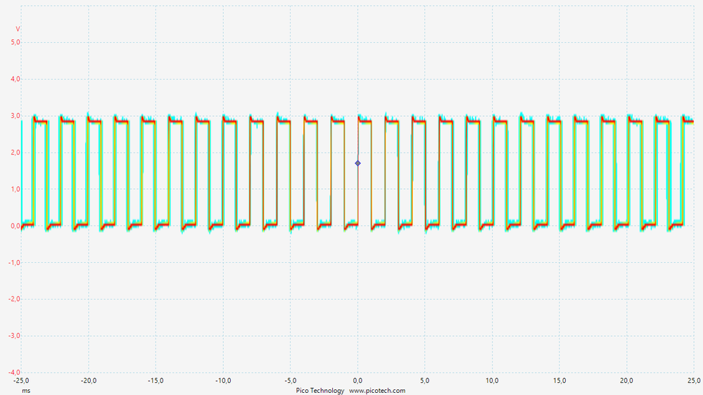

Peter, thanks for the quick reply. I was indeed aware of the statement about jittery falling edges - but thanks for pointing this out again, it is a useful bit of information that was missing from my original post.
I attach a scope snapshot of the 512 Hz signal with "persistence" enabled. Triggered on the blue diamond in the center. As you can see, the farther out you go, the more the edges (both rising and falling) show these as yet unexplained deviations.
Could the output signal be affected by any other activity/peripheral/interrupt? If that were the case, how come this doesn't equally affect the 1 Hz signal?

Any coupling of RTC OUT to the Oscillator pins?
I was secretly hoping for a reply along the lines of "This is a known issue with STM32L476ZETx chips and will be fixed in the next silicon revision."
But a coupling issue is beginning to look likely, I guess.
Not entirely sure how to prove/disprove this hypothesis :(

One more observation: With RTC_OUT_CALIB set to RTC_CALIBOUTPUT_512HZ, I cycled the "LSE Drive Capability" setting through all 4 possible values, and measured the frequency of the resulting signal for each setting:
| LSE_Drive_Capability  | f (512_Hz_Calib_out) |
| low                   | 496.0 Hz             |
| medium low            | 508.1 Hz             |
| medium high           | 524.3 Hz             |
| high                  | 525.2 Hz             |
So I guess this indicates that some sort of coupling is going on between RTC_OUT and the Oscillator in my design. Otherwise the measured frequency should be independent of the "drive capability" (and equal to 512.0 Hz in all cases). Any further comments much appreciated of course, but I suspect there is nothing I can do to fix this issue in software.
Mundungus
Yet another update: Routing the RTC_CALIBOUTPUT_512HZ signal to its alternate pin (PB2), I get a perfect 512.0 Hz square wave. PB2 is located on a different edge of the package - I guess now I know, why! :)
