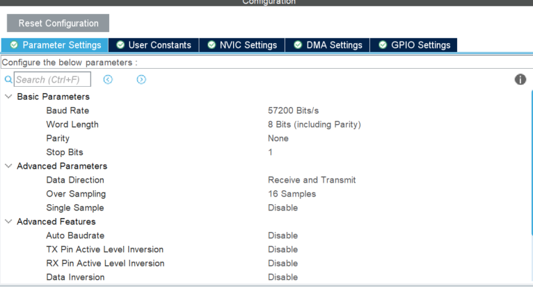

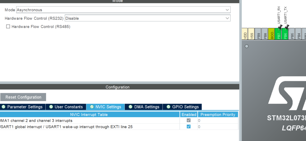

I am using a STM32L073RZT6 MCU and the Cube IDE V1.11. Using the .IOC, I instantiated UART1 on PB7-6 with global interrupts enabled and a DMA service for RX. On the PC side of things I'm using PuTTy as a sniffer and a UART to USB cable for COMS. I have provided screenshots of the configuration, PuTTy output and code snippets below. Each time I transmit a character to the MCU, the rx callback runs twice, but, on the second go around, the rx buffer seems to be reset and transmits 'None'. While I am confused by this added behavior, I mostly am concerned with why it runs the call back twice. Any guidance would be appreciated. Thank you.

KnarfB
Principal III
How do you transmit the char, pressing ENTER?
You may debug your code and inspect the content of the rx buffer.
hth
KnarfB
3 REPLIES 3
KnarfB
Principal III
hth
KnarfB
IHarg.1
Yes.. yes I am. That makes perfect sense now, thank you.
