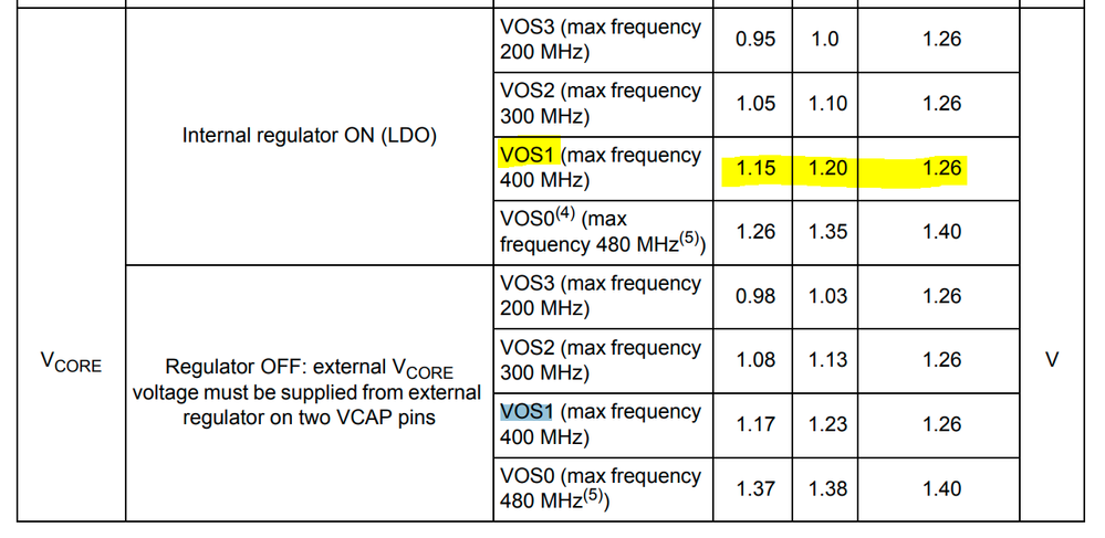

Custom board? How is VCORE supplied? What is voltage on VCAP pins if you measure them with multimeter?
‎2022-03-01 6:21 AM
Yes, a custom board. VCORE is supplied from internal LDO (1.2uF capacitor is connected to VCAP pin). The voltage is 1.01V
‎2022-03-01 6:36 AM
That's below the VOS1 threshold, so bits not being set is the correct behavior.
Not real sure.
There are two VCAP pins, both should have a 2.2uF cap.
