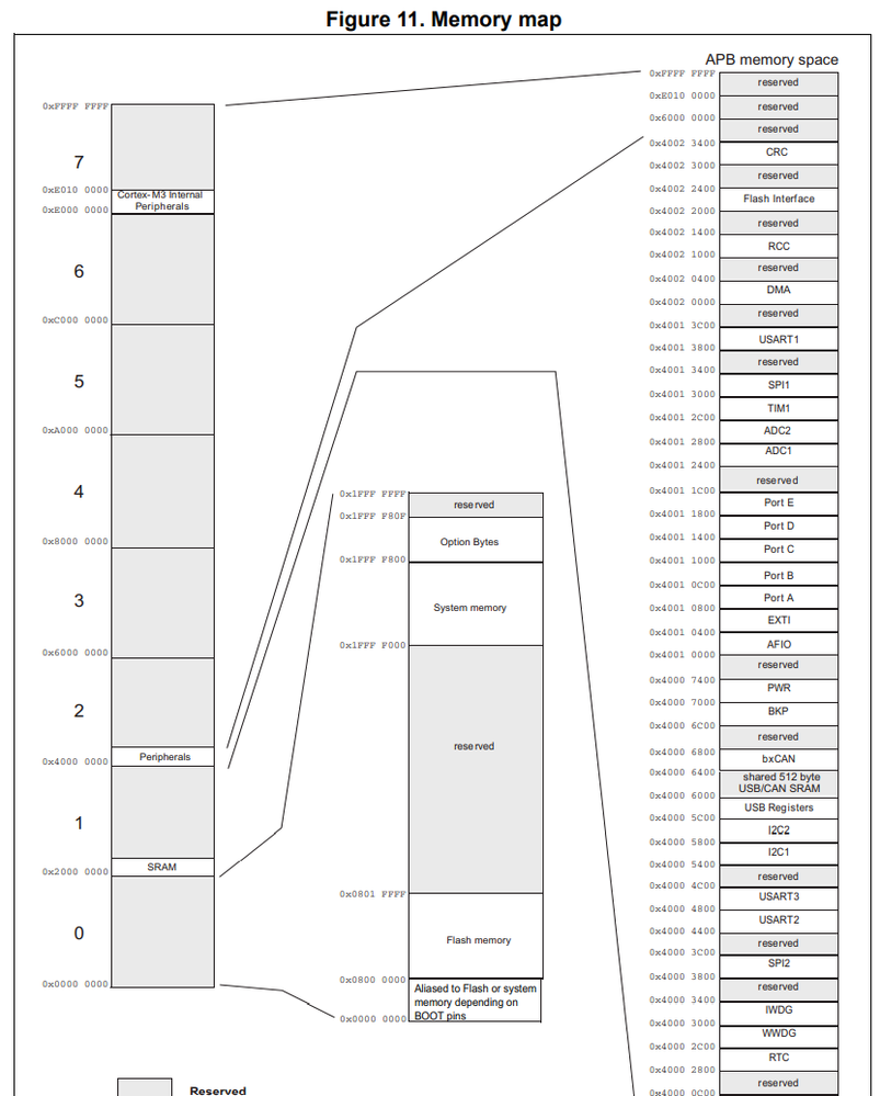

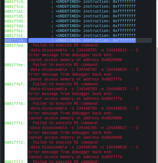

while debugging the program, it hits hardfault handler and sometime it wont
‎2022-03-28 8:49 PM
i check in the disassembly where it showed cannot acces memory address at 0x8020000 and some other address when redebugging
using stm32f103c8t6 mcu
is flash memory being corrupted or something else?
Solved! Go to Solution.

Very, very, unlikley to be flash corruption. Much more likely to be a memory referencing issue.
It sounds like a stack problem or a pointer/indexing variable that is not being initialized to the correct values at start up so that it ends up pointing to an "invalid" part of the memory space. Or it could be the same thing, but the variable is being incremented to the point where it indexes an invalid part of memory.
Are you using an operating system like FreeRTOS or is it a bare metal project? If you are then it could be you are over-running a task stack or you aren't creating the tasks, semaphore or timer correctly. I've run into this a couple of times due to forgetting to do something. These can be tricky faults to find because the hard fault occurs in the operating system.
To test whether you are over-running the stack, fill the stack with a pattern, I use 0xA5A5A5A5 and then when it crashes, look at this memory to see whether all of the stack pattern has been over-written. If it has then you are most likely over-running the stack. Then make the stack as big as you can and test again. If its still being overwriiten it looks like a recursive use of a function that keeps pushing data onto the stack without ever popping data i.e. returning from the function. Also have a look at the stack pointer and see whether it's pointing to an address expected by your program.
