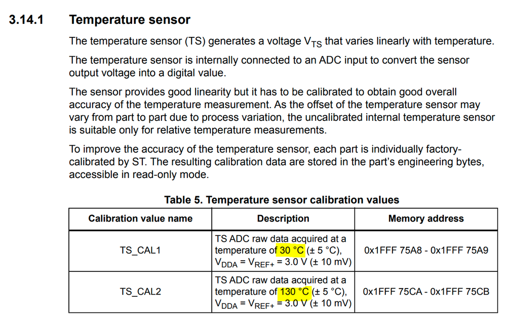

I go to DS12992 Rev 2 Page 24 Paragraph 3.14.1:
The temperature sensor (TS) generates a voltage V TS that varies linearly with temperature.
The temperature sensor is internally connected to an ADC input to convert the sensor
output voltage into a digital value.
The sensor provides good linearity but it has to be calibrated to obtain good overall
accuracy of the temperature measurement. As the offset of the temperature sensor may
vary from part to part due to process variation, the uncalibrated internal temperature sensor
is suitable only for relative temperature measurements.
To improve the accuracy of the temperature sensor, each part is individually factory-
calibrated by ST. The resulting calibration data are stored in the part’s engineering bytes,
accessible in read-only mode.
Table 5. Temperature sensor calibration values
Calibration value name Description Memory address
TS_CAL1
TS ADC raw data acquired at a
temperature of 30 °C (± 5 °C),
V DDA = V REF+ = 3.0 V (± 10 mV)
0x1FFF 75A8 - 0x1FFF 75A9
TS_CAL2
temperature of 130 °C (± 5 °C),
0x1FFF 75CA - 0x1FFF 75CB
So two of the 4 values I need are given in the documentation.

2022-02-15 10:38 AM
From the datasheet, it tells you the temperature at which those values are acquired:
So TS_CAL1_TEMP = 30 and TS_CAL2_TEMP = 130, which is exactly how they're defined in the LL library.
TEMP_DEGC_CAL1 and TS_CAL1_TEMP are equivalent and it should be corrected to use only one name.

2022-02-15 10:52 AM
No it is around 30C and around 130C They say +/- 5C. If they are off by 5 C then it is not calibrated. They need to tell the exact temperature they calibrated it at. not +/- 5C

2022-02-15 10:59 AM
I'm not arguing with you regarding accuracy, but that's not how it's implemented. "Calibrated" is relative. If you need better precision than the datasheet specifies, you'll need to calibrate yourself.
2022-02-15 12:33 PM
I guess I am used to the TI MSP430. When they calibrate it is very accurate. I think +/-0.25 or 0.5 degrees C. Not an order of magnitude higher.
It still does not excuse the name difference. The same file uses different names in the comments.
