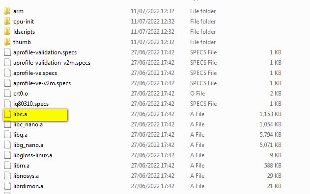

I believe it is in libc.a or some such, but I can't see the config in Cube (32F417) and gradually renaming all candidate files in c:\st\... has failed to locate it (by hopefully throwing up an error).
The project is in c:\xxxxxx\project1 but this library is a compiled one, with no .c source supplied, so it lives in c:\st\ where a new version gets loaded with each Cube installation.

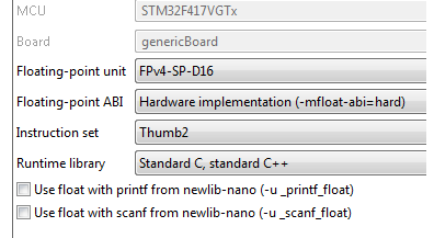

The linker invocation is
arm-none-eabi-g++ -o "XXXXXX.elf" @"objects.list" -mcpu=cortex-m4 -T"C:\XXXXXX\Project1\LinkerScript.ld" --specs=nosys.specs -Wl,-Map="XXXXXX.map" -Wl,--gc-sections -static -mfpu=fpv4-sp-d16 -mfloat-abi=hard -mthumb -Wl,--start-group -lc -lm -lstdc++ -lsupc++ -Wl,--end-group
and the Cube settings are
Background: I need to replace some symbols in there (with objcopy) because the printf, if used for float or long, is calling a malloc and then some mutex functions, but the mutex functions are just empty. But they were not compiled as "weak" so I get duplicate symbol linker errors.

Apt to be an object bound into a library.
If I were fishing I'd be looking with objcopy or fromelf type tools, to disassemble / decompose the libraries.
Grep though the libraries directories.
‎2022-07-25 6:50 AM
There must be a better way... It is probably one of these, but where in Cube is the config for which one?
Then, when I have edited it to weaken the names of those empty functions, I need to put the edited copy of it somewhere, but I don't want to put it back in the same place because the next install of Cube will overwrite it.

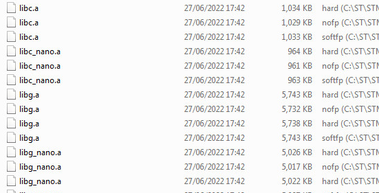

And the actual lib file used varies according to which of the options in my first post is selected. No idea where the rules are for that.
And to make life even more interesting, I have to machines, same Cube project, and on one of them I had to add -u _printf_float under linker options, to avoid a warning from the use of a %7.2 in a printf...

> I am not sure it is actually but have no way of finding it anyway
Look in the link command line for --specs=nano.specs
The nano.specs is a file somewhere in the toolchain library dir, it specifies the actual library and various options.
Next, look at .... plugins\com.st.stm32cube.ide.mcu.externaltools.gnu-tools-for-stm32.../tools/arm-none-eabi/include/newlib-nano/newlib.h
This contains the configuration options used to build the newlib-nano in the toolchain.
Including the infamous _RETARGETABLE_LOCKING and _NANO_FORMATTED_IO
The GNU link also has a way to "wrap" any library function into your own wrapper. (IIRC, Mr. Nadler uses this somewhere in his newlib glue).

In c:\ST\...\plugins\... I find
com.st.stm32cube.ide.mcu.externaltools.gnu-tools-for-stm32.10.3-2021.10.win32_1.0.0.202111181127
under lib I find
and under lib I find newlib.h which is full of interesting #defines like
#define _RETARGETABLE_LOCKING 1
but all this stuff has already been compiled, and I have no sources (except that one from year 1990 which looks pretty similar, right down to using same mutex function call names, 32 years later!).
Also stdio.h is in there.
I see no way to alter any of the symbols already in the libs.
Note I am not using newlib-nano, due to lack of support for uint64 and some thread-safety issues. I am using standard C.
Currently I am investigating a linker (LD) option for suppressing the duplicate symbol warning on specified symbols (have not yet found one) but I have no way of knowing whether I will end up getting my version or the library version. Probably the latter, since it is linked second?
This could be a big job. And that assumes I find the right .a file. I did a string dump of that libc.a and it contains all the printf versions and a load of other stuff. It also contains the mutex functions seen while stepping through printf and malloc etc
__retarget_lock_init __retarget_lock_init_recursive __retarget_lock_close __retarget_lock_close_recursive __retarget_lock_acquire __retarget_lock_acquire_recursive __retarget_lock_try_acquire __retarget_lock_try_acquire_recursive __retarget_lock_release __retarget_lock_release_recursive __lock___arc4random_mutex __lock___dd_hash_mutex __lock___tz_mutex __lock___env_recursive_mutex __lock___malloc_recursive_mutex __lock___at_quick_exit_mutex __lock___atexit_recursive_mutex __lock___sfp_recursive_mutex __lock___sinit_recursive_mutex
