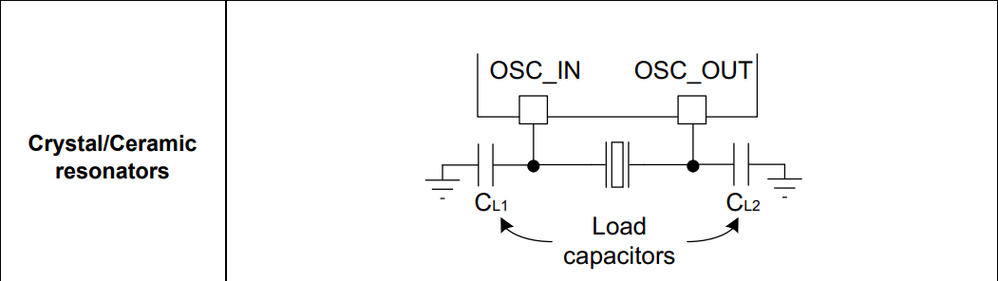

What will be the Capacitor Value corresponding to the crystal??
Champak Kundu
_legacyfs_online_stmicro_images_0693W00000dDWoFQAW.pngIf I use 4MHz Crystal instead of 24MHz Crystal, what will be the value of CL1 and CL2 capacitor?

AScha.3
see ds of your crystal.
if you dont have any info about your crystal, take 2 cer.caps , 16p ...22p and test it.
