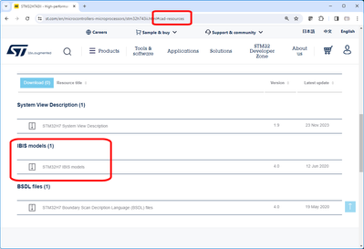

Can you provide the ibis model of stm32h743iit6 chip, thank you!
Here is the link  of the ibis model. You can always find the ibis model on the MCUs CAD RESOURCES on the ST website.
Best Regards.
STTwo-32

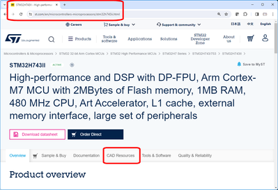

Documentation (including IBIS models) can always be downloaded from the Product Page for the chip in question:
IBIS models will be on the 'CAD Resources' tab:
