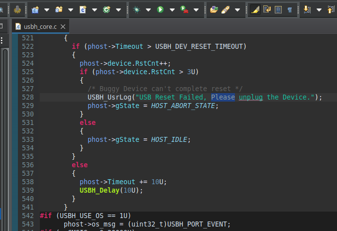

I noticed that there are debug messages advising to disconnect the device from the USB port.
  • But it has happened to me that the USB port remains stuck even after removing the device (keyboard) and reconnecting. I had to reset the MCU in this case.
  • It has also happened that the USB device does not respond after resetting the STM32F407VGT6.
I've tried de-initializing and initializing the USBH via the HALL functions, and it seems to have helped to get it working again, but it didn't completely resolve it. Completely resetting the STM32 using the "NVIC_SystemReset()" command re-established communication most of the time.
Why do you think this has anything to do with the PHY?
Most probably that's a bug in the USBH software. Debug it as usually - develop understanding of how does it work, and then find out at which step does it fail to enumerate the device.
Did you check what do those functions actually do? Did you reset the OTG module using its respective reset bit in RCC?

I modified the way of managing timeout and port reset as well, it was a bit better.
But with the reset commands via RCC the USB module seems to have managed to recover every time it crashed, I hope I'm not celebrating too soon.

void USBH_RecoveryPhost(USBH_HandleTypeDef *phost) {
	USBH_UsrLog("Recovering USB module");
	USBH_HandleTypeDef phost_bkp;
	phost_bkp.id = phost->id;
	phost_bkp.pUser = phost->pUser;
	phost_bkp.ClassNumber = phost->ClassNumber;
	for (uint8_t i = 0; i < phost->ClassNumber; i++) {
		phost_bkp.pClass[i] = phost->pClass[i];
	(void) USBH_Stop(phost);
	(void) USBH_DeInit(phost);
	(void) USBH_Init(phost, phost_bkp.pUser, phost_bkp.id);
	for (uint8_t i = 0; i < phost_bkp.ClassNumber; i++) {
		(void) USBH_RegisterClass(phost, phost_bkp.pClass[i]);
	(void) USBH_Start(phost);
 * @brief  USBH_Process
 *         Background process of the USB Core.
