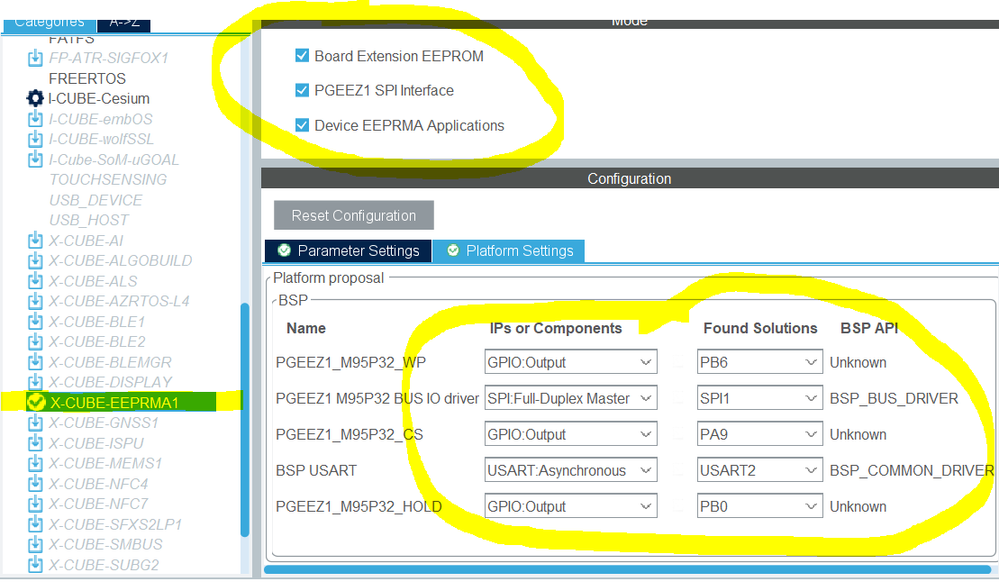

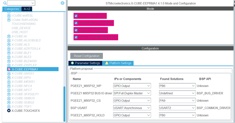

So, going further, let me explain, what problems happen, when you are going to focus on L476 board.
There are two scenarios (with connected X-NUCLEO_PGEEZ1 to NUCLEO L476):
  1. You are launching STM Cube IDE, next you chose bord L476 in board selector, and init all in default mode. Next, you are going to X-CUBE-EEPREMA1, where first proplems appear. Look at the photos.
_legacyfs_online_stmicro_images_0693W00000bkLm1QAE.pngand now - after setting the SPI2 and GPIO's, it everything looks linke that:
_legacyfs_online_stmicro_images_0693W00000bkLlIQAU.pngSo -there is no way to use PGEEZ1 in proper way.

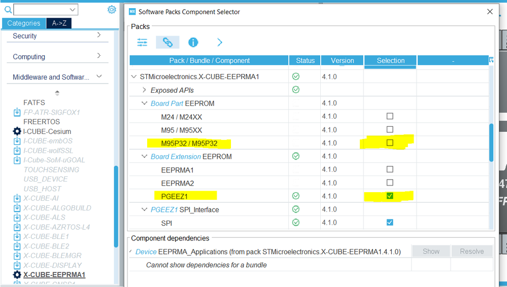

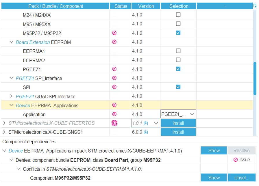

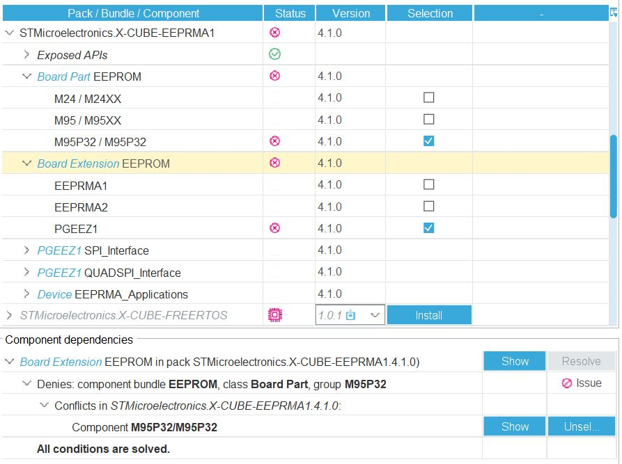

.2. And now second aproach. First - after chosing the microcontroller L476 (not Nucleo, because in Nucleo we have PA5 GPIO acting as a LED, on F401 is also LED connected to PA1, but the github example runs correctly) board and initalising everything, we don't go directly to X-CUBE-EEPREMA1 in Cube, but first - we set up SPI and GPIO's:
_legacyfs_online_stmicro_images_0693W00000bkMBLQA2.pngthan we go to X-CUBE_EEPREMA1 and we see, that also this time nothing can be configured, there are still errors.:
but if we will unmark Board Part EEPROM--> MP95P32/MP95P32 option, and mark only Board Extension EEPRM--> PGEEZ1 option, we will see green signs, that everything is ok:
_legacyfs_online_stmicro_images_0693W00000bkMEyQAM.pngso we might think, that probably everything should go right, after cofiguring nessesary things in PGEEZ1:
_legacyfs_online_stmicro_images_0693W00000bkMHOQA2.pngBut after running the code (no errors), we see that on the USART2:

The same approach in F401 gives also no effect, but when we use GITHUB resources (from link at the beggeining) - everything runs properly on F401 (there is no github example for L476).
The effect is the same (using only CUBE) for the Nucleo's L476 and F401, so I think, if someone will run the PGEEZ1 by cube with success on F401, there will be no problems with running it (by CUbe) on other bards, for example on L476.
Any ideas how to do it? The juimpers are set correctly (J9-J15, according documentation).

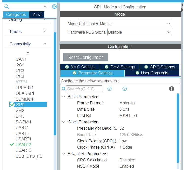

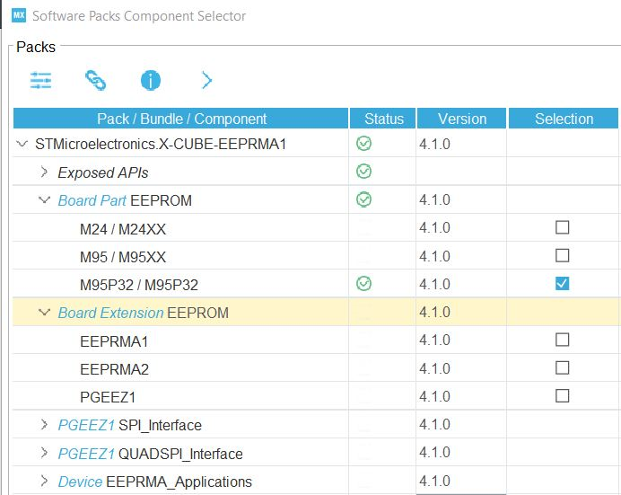

Hi Paul
The software development team was able to run the NUCLEO-PGEEZ1 on STM32L476RG NUCLEO board.
Please find attached a PDF file for the STM32CubeMX configuration.
Do you mind following these steps and run the project ?
Thanks
Thomas
PDobr.1
Your answer solved the problem. I must admitt, everything I did before, was almost right. I didn't put the PA5 to reset state (first mistake), and the settings of PA9, PB0 and PB6 was a little bit different (3rd column, there was Low instead of High). And the "GPIO OUTPUT LEVEL" column was the cause of problems, after changing it to "Low" - the project doesn't run poperly. When I change that parameter to HIGH, everything is fine.
Also, another lesson to learn, thank you for helping me and hope, next user with the same problem will read this thread and use the info.
