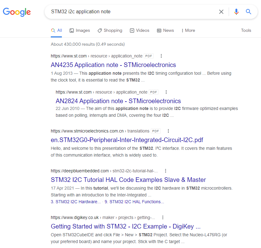

@贲 志强​ ",I was told that STM32 hardware I2C has bug"
Who told you that? Have you asked them why they thought this?
ST has Application Notes on how to properly use the I2C hardware - check on the Product Page for the particular chip(s) that you're using.
Also 3rd-party resources; eg,
