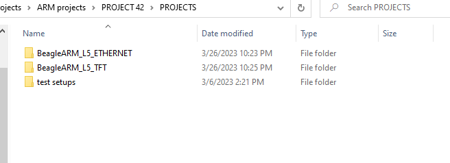

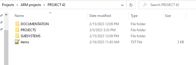

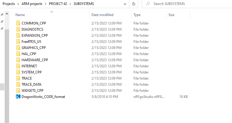

I've had some problems with how CubeMX finds files, so I've had to resort to absolute paths. Because of this, I've tried things and the existing structure of my project reflects the experiments (that didn't work). I've tried relative paths, and the like, and I found that project properties/paths entries don't work well for me. I've resorted to absolute paths. Because the project structure is similar for many projects of this type, the absolute paths work from project to project.
The basic project structure (modified from the default) is to add SUBSYSTEMS, which is a file structure that has all of the common files. It does not include any unique files per project. Each file in SUBSYSTEMS is common to all projects.
0693W00000aJo7EQAS.pngNow the overall directory structure is
0693W00000aJo8vQAC.pngand the project directory is
0693W00000aJo9PQAS.pngand just for fun, the common files are:
0693W00000aJo9eQAC.pngNow, there's no reason that you have to follow this setup, but it does work for me.
