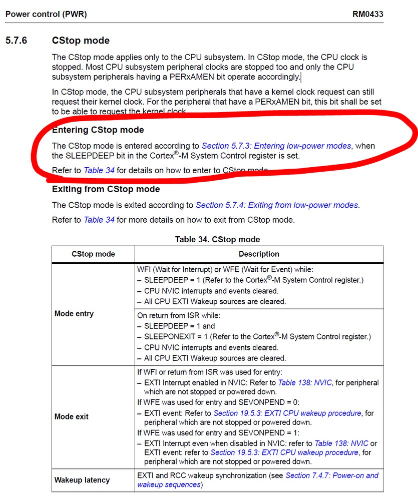

I am bit confuse with how exactly CSTOP and STOP mode are different. Also I can't find anywhere in HAL API how to enter CSTOP. I am using STM32H743.
I know for STOP mode we use HAL_PWR_EnterSTOPMode(..) function. But Function can we use to enter CSTOP mode?
Am I missing something? Let me know as soon as possible. Thank you.

The reference manual has good information on the various low power modes.
So look for functions where SLEEPDEEP is set. This is done in a number of HAL functions including HAL_PWREx_EnterSTOPMode.
