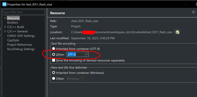

Set the encoding in project properties to whatever it should be, probably UTF-8.
See:
