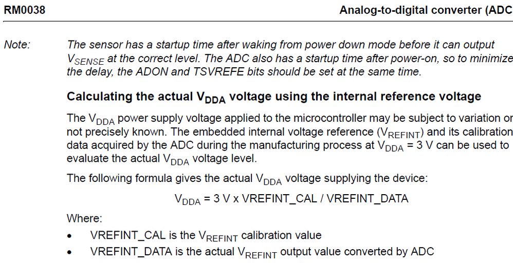

>>> I use this function : HAL_ADC_GetValue(&VDD_measurement);
This function gets converted value only.
Also your ADC_SAMPLETIME_4CYCLES is small.  My suggestion is to increase it at least to ADC_SAMPLETIME_96CYCLES  and after you have a success reading try to calculate the exact timing.
Try to use
uint32_t vdda;
#define VREFINT_CAL_ADDR ((uint16_t*) (0x1FF800F8U)) /* Internal voltage reference,
#define VREFINT_CAL_VREF                   ( 3000U)                    /* Analog voltage reference
HAL_ADC_Start(&VDD_measurement);
vdda=VREFINT_CAL_VREF*(*VREFINT_CAL_ADDR);//VDDA = 3 V x VREFINT_CAL / VREFINT_DATA
HAL_ADC_PollForConversion(&VDD_measurement, 1000);
vdda /=HAL_ADC_GetValue(&VDD_measurement);
The vdda value will be in millivolts.
Use the same way to read the PA2  Start, Wait, Read.
