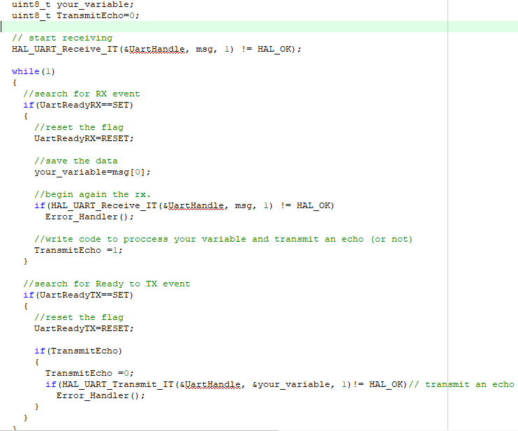

Posted on August 30, 2017 at 17:49
This question is difficult to answer.
It depends to what you want to do. (some protocol etablished)
An approach is to wait for a single byte,
after to proccess the byte fast enough before the next byte arrives.
and after transmit or not an echo byte(or something other you want.)
But for sure must not blocking the execution by writing while(someting){;}
The TX part of USART must not blocked from RX part and vise versa.
Handle the RX and Tx part asynchronously . something like below
UartReadyTx must be set inside
HAL_UART_TxCpltCallback
UartReadyRx must be set inside
HAL_UART_RxCpltCallback
Have a look also to this post of community
https://community.st.com/0D50X00009XkW2nSAF
Regards
vf
