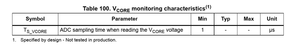

If just for interest : try to measure it , with the ADC ->
Interesting, thank you AScha.3! Yes I assumed the datasheet correct but wanted validation in response to someone on the hardware team at work
I also really appreciate your feedback on the relevance for voltage levels! We will be in review (and your ADC measuring reference - GOLDEN, thank you)

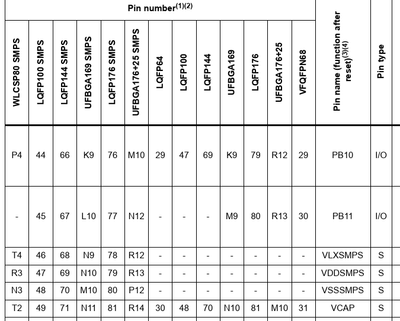

Maybe even faster : look at the VCAP pin (at your case) and check just with a DMM . (core voltage)
Then you see, what your chip doing . :)
