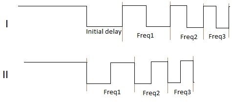

Posted on August 29, 2014 at 03:59
Is it necessary to you DMA for capture compare .
I am using timer1 channel 1 as output compare, to generate a pulse of variable period.
The output mode is set to toggle mode and the polarity is set to active high. T
he capture register is set to delay period and then in next capture register set to first period and next period will be updated after the one pulse is completed.
I is correct expected output. II is wrong in this case the wrong ramp profile and driver consider wrong first step .As driver  considers first rising edge as first step
Posted on August 29, 2014 at 04:20
The use of DMA would depend on what frequency you want to generate and how practical it is to interrupt.
With toggle mode you get to control where the edge transitions are placed with respect to the time base of the counter, if you want a longer lead in, then push out the edge further.
