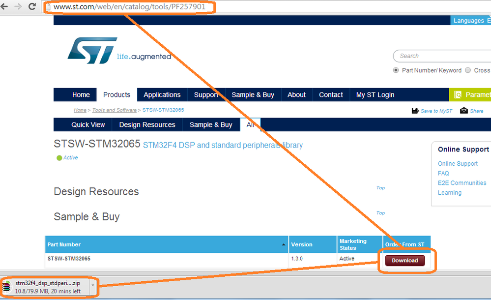

Thanks Clive, But I am not able to get the STM32 Library, Can you provide me the link?
sanjib
Posted on January 30, 2014 at 14:46
Hi Clive,I need to control two steeper motor each having two coils through mosfet. How can I achieve in Stm32f4. I went through some examples but it was not clear, do you have any reference code relevant to my requirement along with a better understanding documents , notes whatever, and moreover was not able to get the STM32F4xx_DSP_StdPeriph_Lib_V1.3.0, where is this exactly I searched in google as well.
Posted on January 30, 2014 at 16:28
http://www.st.com/web/en/catalog/tools/PF257901
sanjib
Posted on January 31, 2014 at 04:48
Only one thing in the same link I didn't find any path mentioned by you . It is just about
http://www.st.com/web/en/catalog/sense_power
, Application and support. I am not able to find it . and any sample code for driving two motors . please
