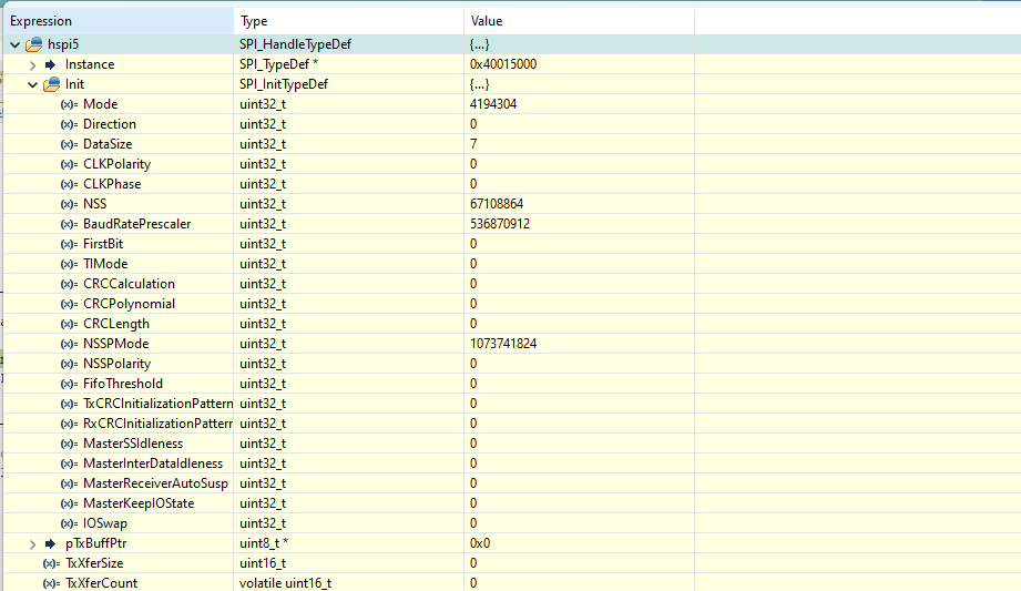

using SPI, do we need to control the pins?
‎2022-11-29 9:14 AM
I'm trying to set up the SPI5 for a test but see a lot of references online indicating the pins modes need to also be set. I figured the driver would do that. The init seem pretty straight forward.
but the transmit does not. Do I need to set my pin mode or is this enough?
HAL_SPI_Transmit_DMA(&hspi5,data_to_send, sizeof(data_to_send));
while(HAL_SPI_GetState(&hspi5) != HAL_SPI_STATE_READY);
I do not see any activity on the wires.

‎2022-11-29 6:59 PM
Yes, you do need to initialize GPIO.
Here is the code generated by STM32Cube:

‎2022-11-29 7:00 PM
This codd configure the peripheral IP, it does not tell where thr SPI internal signals are routed to which pins, as there are various options. Both SPI and GPIO registere should be cpnfigured. You can run your code, put a breakpoint in your while trnasmitting loop, and manually edit the gpio registers until the main loop sends data through the chosen pin, for example.

‎2022-11-30 6:53 AM
not fully absorbing this. I most certainly can break my code at HAL_SPI_Transmit
I can see all of this
‎2022-11-30 7:10 AM
I have all the SPI wires on a scope and only the SPI5_NSS / USART7_CTS (PF6/PF9) shows a signal.
‎2022-11-30 7:46 AM
It is also possible its my board I'm using. stm32h735ig
the manual shows
Figure 13. P2 STMod+ connector to hold the SPI5 but looking at the pins on the chip, they do not match up right. I find this board document really hard to follow. How can MOSI of SPI 5 be either PF9, PF7, or PE11 ?
I do not care what SPI I use but I need the BGA pins exposed on the board somewhere. anyone know of a page that shows where the pins go?
Also Pmod shows the same.
1 SPI5_NSS / USART7_CTS (PF6/PF9)
2 SPI5_MOSI / USART7_TX (PF9/PF7)
3 SPI5_MISO / USART7_RX (PF8/PF6)
4 SPI5_SCK / USART7_RTS (PF7/PF8)
this is the manual I use but its not very helpful in some respects.
file:///C:/Users/sean_32bvxh7/Downloads/um2679-discovery-kit-with-stm32h735ig-mcu-stmicroelectronics.pdf
‎2022-11-30 8:04 AM
oh boy, starting to maybe get this...
So the line I see working is my out data, I know this because changing my data out matches (hard to read without a clock). and my MOSI is configure as PF9 and that happens to be the Pmod 1 (1 SPI5_NSS / USART7_CTS (PF6/PF9) ) Where I see data on the wires
The IOC says SPI5 clock is on PH6 but the board says it can ( or should be ) on PF7/8
So there must be a way to set SCK and MISO to PF pins, but how?
I also see uart7 is in use in my project, maybe this is a conflict?
‎2022-11-30 8:41 AM
ah I was able to get it from the LCD connector.
