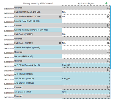

I am in the process of designing a product which is based on the STM32-H753 and requires P/SRAM.
However, I'm concerned the H753 might not support on PSRAM with QSPI, I need the PSRAM for write/read.
I haven't found any application notes or examples from ST showing connection QSPI PSRAM into the STM32  only for FMC or OCTOSPI Flash.
Has anyone successfully used QSPI PSRAM with STM32H7 ?
Are the specific requirements or limitation I should be aware of ?
(attached reference images for context):

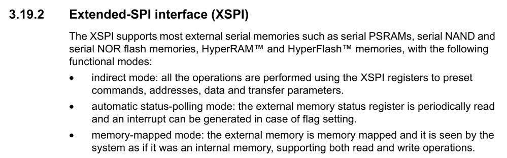

Maybe other idea: look at the H7S3 /7 series with xspi :

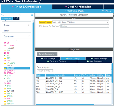

I Can't understand you sorry,
If I'm using QSPI for connecting PSRAM why the MCU cares about who connect to him? the MCU communicate with PSRAM on QSPI interface and that's all? I don't need it to be memory mapped, just to store data .

Ok, i see,could work, so read :  AN4760
https://www.st.com/resource/en/application_note/an4760-quadspi-interface-on-stm32-microcontrollers-and-microprocessors--stmicroelectronics.pdf
I would do a real test: if you have a nucleo board with H7xx , connect a small so8 adapter with short wires and test it,
with the issi PSRAM . Not much effort , but then you know it 100% .

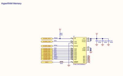

ok thank you,
just want to connect it as "device" and we need driver, etc..
What i found: see MB1520b , H735I board :
with S70KL1281DABHI023
S70KL1281DABHI023 is a 128 Mb HyperRAM™ with DDR, 100 MHz clock, and 3.0 V I/O.
https://gist.github.com/thomask77/c65d7d1017e88ae0dd47d8b416fef0cb
https://www.st.com/resource/en/application_note/an5188-external-memory-code-execution-on-stm32f7x0-value-line-stm32h750-value-line-stm32h7b0-value-line-and-stm32h730-value-line-mcus-stmicroelectronics.pdf
external SDRAM, external SRAM or external OSPI-RAM for code execution
