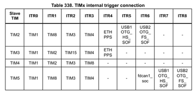

I did start another approach, because in the documentation states that by not using HSYNC/VSYNC you can not work with 14bit data. At least that is what I understand by now. Maybe someone will teach me something different, please.
I generate DCMI PXCLK using TIM2 at 24MHz ,and chain TIM3 HSYNC 30 kHz, and TIM4 VSYNC 60 Hz.
I will test using this configuration to see if DCMI will loose samples.
On the run I will need your valuable help.
If someone consider useful, here is the timers TIM2 -> TIM3 -> TIM4 chaining function, tested with oscilloscope and working:

  // TIM3 counts TIM2 update events (pixel clocks)
  sSlaveConfig.SlaveMode = TIM_SLAVEMODE_EXTERNAL1;
  sSlaveConfig.InputTrigger = TIM_TS_ITR1;               // TIM2 -> TIM3
  HAL_TIM_SlaveConfigSynchro(&htim3, &sSlaveConfig);

  // TIM4 counts TIM3 update events (lines)
  sSlaveConfig.InputTrigger = TIM_TS_ITR2;               // TIM3 -> TIM4 (ITR2 on H743)
  HAL_TIM_SlaveConfigSynchro(&htim4, &sSlaveConfig);
  sConfigOC.OCMode = TIM_OCMODE_PWM1;
  sConfigOC.Pulse = 1;                                   // VSYNC 1 line (33.3 µs)
  sConfigOC.OCPolarity = TIM_OCPOLARITY_HIGH;
  HAL_TIM_PWM_ConfigChannel(&htim4, &sConfigOC, TIM_CHANNEL_1);
