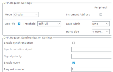

> It'd be really nice if the HAL had a HAL_ADC_DMA_MultiBufferStart() or something like that.
For "double buffer" - it has. Is called : circular buffer, because you want "endless" continuous stream - right?
Using it , is very easy : just in Cube set circular buffer, inc. memory, source&destination size (byte, word..), and enable callbacks in "Advanced settings" .
And in main : on half- and full buffer callbacks move data , wherever, to use it.

You can use a circular buffer with the half xfer complete interrupt to have the same effect as using the double buffer built into the DMA streams but it's less efficient. The STM32 DMA streams have double buffering solely for this reason. Look up the DMA_SxM0AR and DMA_SxM1AR registers in the reference manual. Without using interrupts you should be able to look at the CT bit in the CR and know which buffer is being used by the DMA and which is available for processing the results.
Honestly my HAL_ADC_MspInit() called by HAL_ADC_Init() looks very different from yours, but it's also from a common library in my company that is supposed to be generalized. The one in your picture assumes you're always using DMA1_Stream1 for any ADC handle passed to it. Also, did you make no changes after MX generated this at all? For example some of the comments in your function don't look like something that MX would make and it's missing all of the assert_param() statements checking the handle parameters.
It seems like you possibly could call HAL_DMAEx_MultiBufferStart() after this HAL_ADC_MspInit() although you'd need to use the link in the hadc handle to get to the handle for the stream. Honestly though, I'd need to run it and look at the registers to be sure that it's actually set up to handle the double buffered DMA correctly.
Code I posted is out of CubeMX examples for stm32H743zi2 , all comments as it is. You can download it here:
