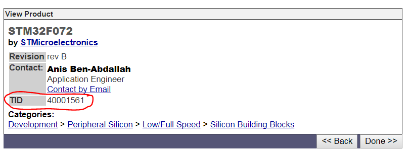

, Test IDs (TIDs) are assigned by the USB-IF or by the certified independent test lab at the time of testing.
In order to get the TID number of a certified USB , you have to visit the
http://www.usb.org/kcompliance/view/catalog_search/sselect_item/process/refresh?profile=b53bcd5efdcd514ee2b6df3a16feb10f5294b275&referring_url=http%3A//www.usb.org/channel&keywords=STM32&step%3Aint=2&tab_data_namespace=28681966A78ZIB4vgcw&sitemlist_batch_start%3Aint=1
Below, you find an example of the STM32F072(LS/FS):
