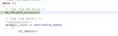

Since communication with the GMSL module is integral to the project, I must utilize the STM32, as using a Raspberry Pi is not an option. I've already developed a project using USB HOST functionality. However, I'm encountering an issue where the Appli_state remains in a state of not being ready.
Please use this button to properly post source code:
So how come your classmate is using a Raspberry Pi?
Does that work with a standalone FT232RL - eg, on a breakout board or in a cable?
Or with any other USB CDC device?
So what state is it in?

  while (1)
    /* USER CODE END WHILE */
    MX_USB_HOST_Process();
    /* USER CODE BEGIN 3 */
    //userfunction();
    if(Appli_state == APPLICATION_READY)
    CDC_HANDLE();
  /* USER CODE END 3 */
