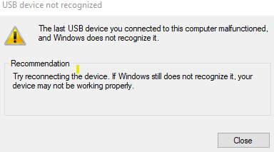

I am using nucleo L4R5ZI-p i am trying to use USB with for virtual comport the and i am following STM32 tutorials for USB driver development when i am connecting usb to the device the device manger in sot able to read showing this dialog box
Note i am using WIn 10
i need to update or install any driver or software or any other changes in software level or hardware level

Hello @PESHWA ,
I advise you to follow this FAQ: USB device not recognized - STMicroelectronics Community
Make sure to upgrade the Firmware of the STLink (go to ST-LINK>firmware update) or through this Link STSW-LINK009.
Imen
