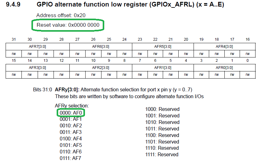

Posted on December 26, 2014 at 04:13
Dear Sir
I missed one word of my last post
I configured the USART1 for pin PB6 - PB7 and it is working but stranger is it does
NOT
care about following codes
Probably because the reset setting of the bits related to the AF Mux are zero
Dear Sir I could not got above
Please advice
Probably because the reset setting of the bits related to the AF Mux are zero.
