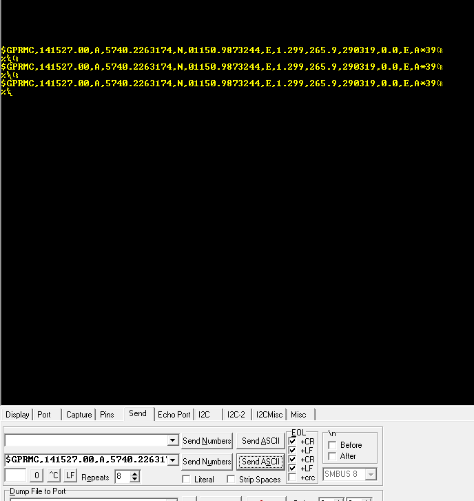

Well, i got it to fire by introducing a new boolean variable that gets set whenever all the string is recieved and processed. It seems to work for all multiple strings that i throw at it but now its having another symptom. It Sends the string back three times....lemmi show u what i did...

i thought the problem would be that rcvd_str wasnt reset, so i tried to reset it at the end of every puts, but it doesnt seem to give me the desired results
This is what happens to me when i execute it in RealTerm. Am sending a string like "$GPRMC,141527.00,A,5740.2263174,N,01150.9873244,E,1.299,265.9,290319,0.0,E,A*39"
But its sending it back three times and on everytime, appends a BELL control character. At times it appends a BSL (Back slash)
Need to terminate the string properly.
Might need to clear overrun, framing, noise type errors.
Use TXE not TC to determine if USART can take data.
NMEA data may exceed 50 characters.
Variables that change via interrupt should be volatile.
