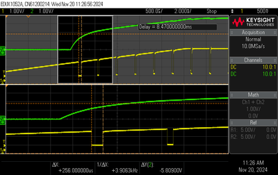

We notice the startup time from power up can be affected by setting one GPIOB pin to input. The startup time here refers to the time from SystemInit() until main(). Basically it contains scatterload and __rt_entry to my understanding.
Specifically, the sample code below, built with ARM Compiler 6.16 Tool, would demonstrate that
#define MEASURE_PIN 5
int main(void)
  IO_SET_PIN(GPIOA, MEASURE_PIN, 1);
  // Enable IWDG
  IWDG->KR = 0xCCCC;
  // Enable write access
  IWDG->KR = 0x5555;
  // Set prescaler
  IWDG->PR = 0;
  // Set reload
  IWDG->RLR = 1;
  // Wait for the registers reload
  while (IWDG->SR)
  // refresh the watchdog.
  IWDG->KR = 0xAAAA;
  while(1);
  return 0;
void SystemInit(void)
  // enable GPIOA clock
  RCC->IOPENR |= RCC_IOPENR_GPIOAEN | RCC_IOPENR_GPIOBEN;
  // set GPIOA pin5 to output
  IO_SET_PIN_DIR(GPIOA, MEASURE_PIN, 1);
  // set GPIOA pin5 to low
  IO_SET_PIN(GPIOA, MEASURE_PIN, 0);
  // Set GPIOB pin7 to input
  // GPIOB->MODER &= 0xffff3fff;
Basically GPIOA pin 5 is toggled to low and high for the time between SystemInit() and main() to be measured.
main() also has IWDG setup and ends with a while loop so that IWDG reset happens periodically since power up.
On the oscilloscope it looks like the screenshots below.
Respectively from the screenshots, it can be observed that the 1st startup(power up) takes 254 μs while the 2nd startup (IWDG reset) takes 132 μs.

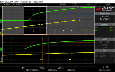

Now if uncommenting this line GPIOB->MODER &= 0xffff3fff; and redo the measurement, we get the results below.
We can see that having the GPIOB pin 7 set to input reduces the startup time from 254 μs to 132 μs and the rest startup remains taking the same time.

The scope pictures are as follows:
At what voltage does the first edge happen? For me it seems this is below minimum V(POR) = 1.9 Volt and probably also below minimum V(PDR) = 1.88 Volt . This would mean that the part is outside the "5.3.3
Embedded reset and power control block characteristics" specs. And "5.3.1 General operating conditions"  and so the whole part is only specified for operation from minimum V(PDR)  up to 3.6. Volt.
So the question is: Why does your part work below minimum V(PDR at all!
Why are green and yellow voltages different? Are external pull-ups used on MCO and GPIO? Why the dropouts on MCO when GPIO is low? Show your schematics!
@Uwe Bonnes Just to clarify, TIM16 is not linked to MCO, rather just as an indicator of when the frequency becomes stable.
I'm checking various things and see if it has impact on the measurement, e.g. whether ground is valid, any accidental pull up.
But I doubt it would have an impact on the timing. Has anyone here tried it and can confirm whether seeing or not seeing the same?

The MCU is running on HSI48 with the default DIV so at 12 MHz. One observation worth mentioning is that if I set the frequency to 48MHz in SystemInit(), both reset time (power up and IWDG reset) takes the same at around 40 μs.

> And initalizing the ram-variables (in __rt_entry) shouldn't take up any time as I don't see any global or static variable in your code. I suspect the internal clock is not fully stabilized yet.
0x400 bytes starting at 0x20000020 are set to zero - there are 256 word writes.
If the loop takes 6 cycles to execute, which IMO it can, that's around 130us at 12MHz clock.
