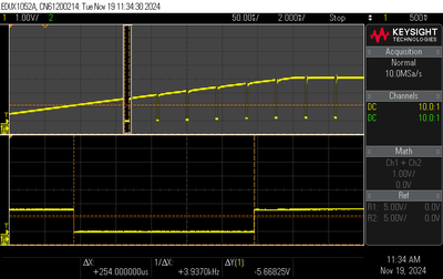

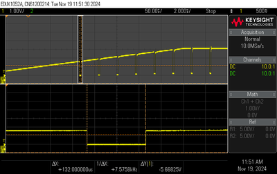

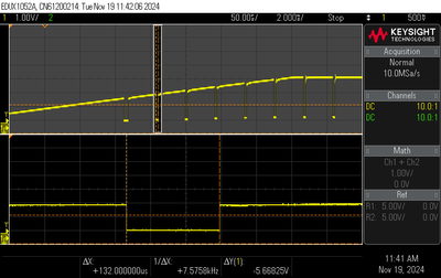

On the oscilloscope it looks like the screenshots below.
Respectively from the screenshots, it can be observed that the 1st startup(power up) takes 254 μs while the 2nd startup (IWDG reset) takes 132 μs.
Now if uncommenting this line GPIOB->MODER &= 0xffff3fff; and redo the measurement, we get the results below.
We can see that having the GPIOB pin 7 set to input reduces the startup time from 254 μs to 132 μs and the rest startup remains taking the same time.

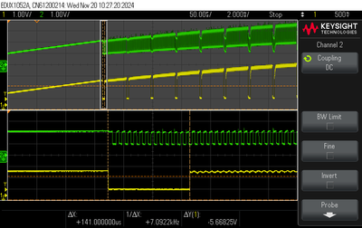

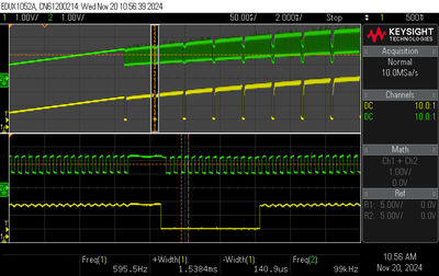

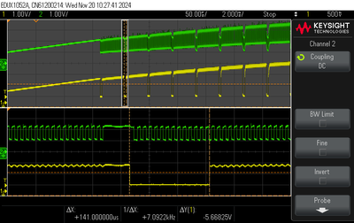

@Uwe Bonnes That's actually how we initially discovered the behaviour. We wanted to measure whether HSI has become stable but the test point of MCO was not available so we used PB7 with alternate function setting to TIM16_CH1, PSC being 0, ARR bring 120, and CCR1 being 60 so we expected to see 99,174 Hz.
By changing the PB7 direction, we are also seeing the startup time from power up accelerated to be the same as the rest of IWDG reset.
Together with the frequency measurement, attached scope pictures below.
1st reset at power up
2nd reset at power up
99kHz
