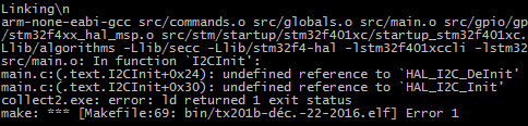

Hello everybody,
In first time, I'm sorry for my english! ^^
I'm trying to configure an I2C communication for a MCU STM32F401RT6. I don't use ...Cube_MX but I use STM32f4xx_HAL Library for different reason and not STM32f4xx library.
My program compile but there is a problem with the linker => I have the famous error message : undefined reference to 'HAL_I2C_Init' (Yes, again and again this error message ^^).
To simplify, I removed other file .c and .h and I keep just Main program.
Here main.c Program
#include ''stm32f4xx_hal.h''
#include ''stm32f4xx_hal_def.h''
#include ''stm32f4xx_hal_i2c.h''
#define I2Cx I2C1
#define I2Cx_CLK_ENABLE()                                     __HAL_RCC_I2C1_CLK_ENABLE()
#define I2Cx_SCL_GPIO_CLK_ENABLE()                __HAL_RCC_GPIOB_CLK_ENABLE()
#define I2Cx_SDA_GPIO_CLK_ENABLE()               __HAL_RCC_GPIOB_CLK_ENABLE()
#define I2Cx_FORCE_RESET()                                __HAL_RCC_I2C1_FORCE_RESET()
#define I2Cx_RELEASE_RESET()                            __HAL_RCC_I2C1_RELEASE_RESET()
#define I2Cx_SCL_PIN                                               GPIO_PIN_6
#define I2Cx_SCL_GPIO_PORT                               GPIOB
#define I2Cx_SDA_PIN                                              GPIO_PIN_7
#define I2Cx_SDA_GPIO_PORT                               GPIOB
#define I2Cx_GPIO_MODE                                        GPIO_MODE_AF_OD
#define I2Cx_GPIO_PULL                                           GPIO_PULLUP
#define I2Cx_GPIO_SPEED                                        GPIO_SPEED_FREQ_HIGH
#define I2Cx_SCL_AF                                                 GPIO_AF4_I2C1
#define I2Cx_SDA_AF                                                 GPIO_AF4_I2C1
static I2C_HandleTypeDef hi2c;
bool I2CInit(void);
int main(void) {
I2CInit();
bool I2CInit(void) {
hi2c.Instance = I2Cx;
hi2c.Init.ClockSpeed = 100000; // 100kHz
hi2c.Init.DutyCycle = I2C_DUTYCYCLE_2; // 50% duty cycle --> standard
hi2c.Init.OwnAddress1 = 0x00; // own address, not relevant in master mode
hi2c.Init.AddressingMode = I2C_ADDRESSINGMODE_7BIT; // Set address length to 7 bit addresses
hi2c.Init.DualAddressMode = I2C_DUALADDRESS_DISABLE; // Disable seconde Address
hi2c.Init.GeneralCallMode = I2C_GENERALCALL_DISABLE; // Disable general call
hi2c.Init.NoStretchMode = I2C_NOSTRETCH_DISABLE; // Disable no stretch
hi2c.Devaddress = 0x3B;
if (HAL_I2C_DeInit(&hi2c) != HAL_OK) {
return false;
if (HAL_I2C_Init(&hi2c) != HAL_OK) {
return false;
//HAL_I2C_MspInit(&hi2c);
return true;
I compile and link with a makefile and config.mk on Cygdrive terminal.
here the message on my terminal.
I don't see where is the problem. I looked for on google but I didn't find a solution. I specify that the stm32f4xx_hal_conf.h include HAL_I2C_MODULE_ENABLED
Do you understand where is the problem?
Thank you very much for your assistance?
Régis

Imen.D
Posted on December 26, 2016 at 15:15
Dear
loucas
It seems your pathis not configured properly.
Make sure that your project has the right include paths and source files from the same tree.
Best Regards
Imen
