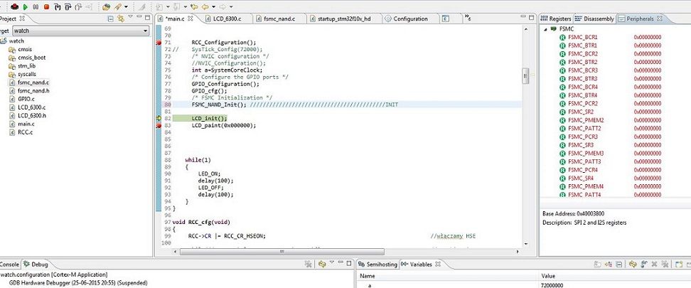

My name is Peter and my hobby is electronics, programming and robotics. Recently I got interested in STM32 and decided to build my own evaluation board. Currently I have a problem with FSMC. I want to drive an LCD display through it, but I cannot change the registers' values. Of course the clock for FSMC is on. I have even tried to change them directly (manually) in coocox debug view,  with no result. Can You tell me, what I need to turn on (except the clock source) to be able to write these registers ?

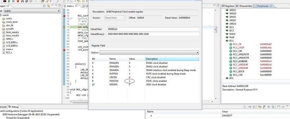

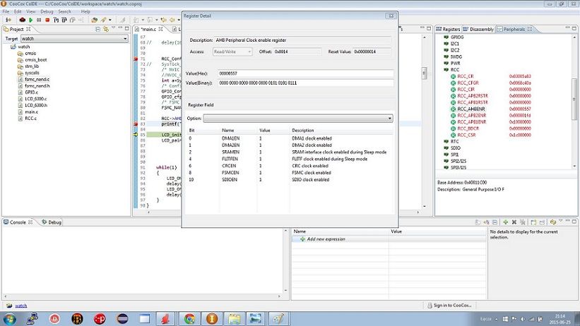

Does the FSMC bit in AHBENR actually assert? There are members of the STM32F1 family that don't support FSMC
Try
RCC->AHBENR = 0xFFFFFFFF;
printf(''%08X\n'', RCC->AHBENR);

0690X0000060324QAA.jpg 0690X00000602voQAA.jpg As You can see after initialization the registers stay untouched. But after Your piece of code the registers of RCC are all 1 as they should be : 0690X00000602vpQAA.jpg ''There are members of the STM32F1 family that don't support FSMC'' Actually I have checked it, and STM32f103VCT6 has the FSMC, so i don't know what I'm doing wrong. Greetings, Peter From: clive1 Posted: Thursday, June 25, 2015 7:35 PM Subject: Unable to write FSMC registers

May be it's the tool?
Suggest you read the FSMC Bank 2 register directly in your own code, and decode/decompose them there.

Hmmm it seems You are right ! It has to be the tool, because the values of registers differ before and after writing to them. It's veird becasue I have tried another IDE - eclipse, ant there was the same problem. Anyway, I'll try to read them with keil, and I'll inform You of the results.
