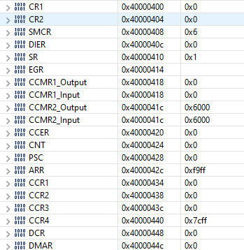

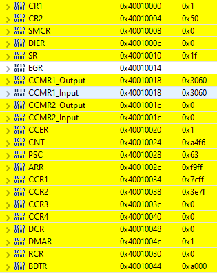

The registers after initialization look as follows:
TIM1
0693W00000QKxDDQA1.pngTIM3

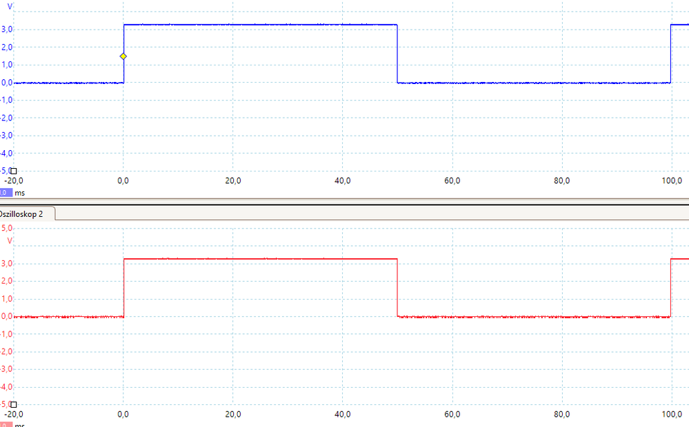

With this setup my signals are just in phase, with the second one just 40us behind, which you cannot see in this snap

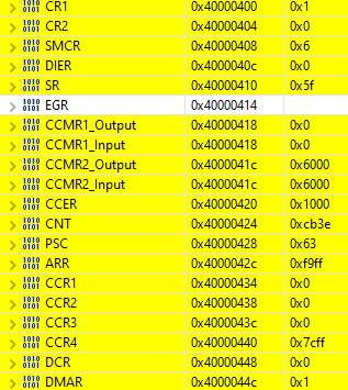

TIM1 after call to MX init
0693W00000QKyF5QAL.pngTIM3 after call to MX init
