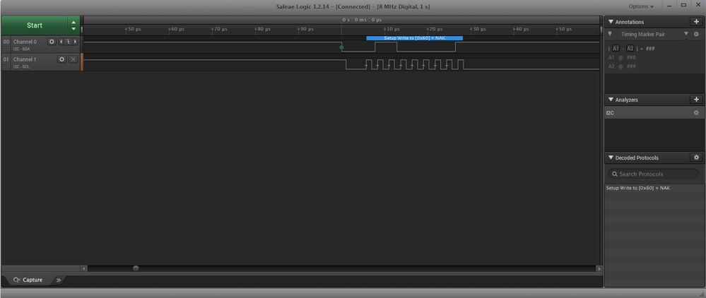

So this tells me that my master (Variscite) board is not detecting my master. I also tried sampling my transmitted data with Salae Logic Analyzer. Based on the image below, its writing to the wrong address, it writes to 0x14 [NAK], but I specified 0x00 for my data address and 0x0A as my chip address, so why is it writing to 0x14?
So again, slave is not being acknowledged. But I have no idea how to get the slave to acknowledge.
Update
I believe my problem is that Slave is not able to receive properly. The data is actually sending to the correct address 0x14 (I forgot that I had to shift it to the right 1 because of the R/W ACK bit). I used HAL_I2C_Slave_Receive
